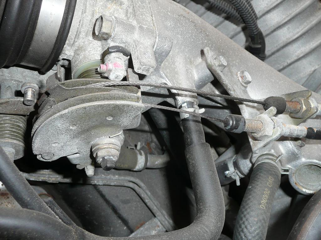

| Posted: Mar 27 2011 at 5:29pm | IP Logged
Their is no cable slack. The only play is from stop to stop when the pulley rotates. Here's a picture. I would have done this sooner but I'm used to forums that won't let you upload photos, only link to them.

| Posted: Mar 27 2011 at 7:20pm | IP Logged
Nice picture! With the engine running at operating temp.,
ther should be just slight "play" in the cruise cable. From
what I'm seeing, it looks good even though the throttle is
not on it's stop. Could you explain to a PC challenged
person(ME), how to upload photos?
