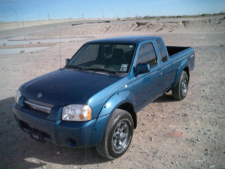

I have a 2002 Desert Runner. It handles its own (for being a 4x2) off-road. I could really use a locking rear diff. what do i have to do?
Thanks in advance...
