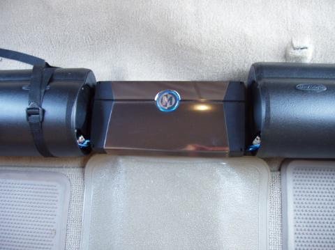

I bought the same CC 06 with the upgraded Fosgate setup. Not worth $850.00. The sub box really don't kick, espeacially with the 6 other speaker going on the truck. You can even hear the bass from the subs. But the head unit is quite remarkable. Very impressed. Play mp3 and in some radio station here in Cali. you get the name displayed, song and artist playing. What I did is replaced the stock sub box with 2 6.5" SAS bazooka tubes with a Memphis 500 mono amp and this baby rocks. Definitely recommend this setup. They fit perfectly snugg underneith the rear seats. Bass sounds amazing even with the amp at alittle past half way.
