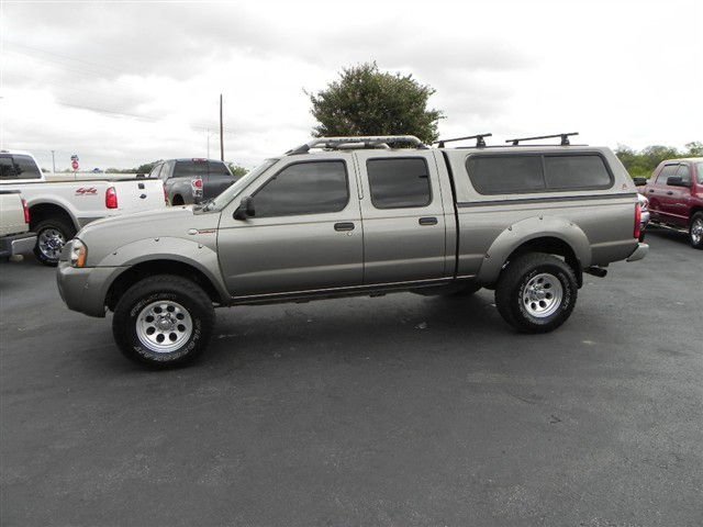

A quick background of the truck: Got a 2002 V6 supercharged Frontier 4X4 about 5 months ago. Whoever had it before me did several things to it that I'm now working around. Here is what they did:
- ghetto rigged a flowmaster muffler underneath and added a dual exhaust. It was ghetto rigged because it was the wrong type of exhaust for the truck, and plus wasn't meant for dual exhaust so it ended up just getting incredibly hot and creating a ton of drag. Not to mention the mufflers (though they looked really cool) were getting so hot they were constantly disconnecting from it's supports which was really annoying. Anyway, i just got the whole thing removed and put on a stock muffler until I decide what I want to do permanently.

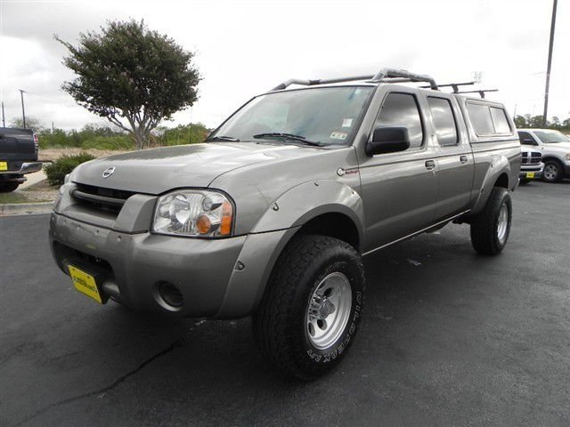

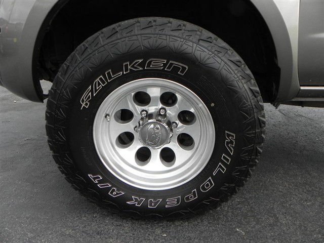

- Put too big of tires on it. Don't get me wrong, I'm all for big tires and plan on getting bigger. The problem is that they didn't lift it up at all. They lifted it via the torsion bars as much as they possibly could and still had to get spacers that make the wheels stick out on the sides. All that and the front 2 STILL rub on the fenders pretty bad when i hit certain inclines.

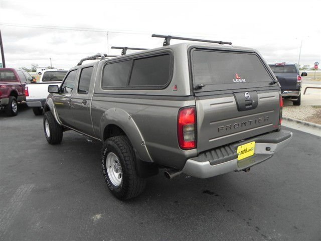

- Tinted the back windows so dark I literally can't see out at night
- Doesn't have much to do with them, more of a general thing about the truck, but the mpg is awful. Worse than I was expecting. I took the camper off the back as soon as I got it, so it's not being weighed down by that. I've been getting about 13 mpg on the highway (that's about 230 miles out of a full tank of 16 gallons). And it was sucking power somewhere too. I realize all vehicles run better when they're cooler, but holy crap when it got cold in texas a month or so ago, she would be WAY WAY more powerful in the morning. Then after running for 5 minutes or so she feels like she's dragging again. I thought this had a lot to do with the muffler fiasco, but after I switched out to the stock muffler, i got WORSE mileage than before and no real performance difference! What the heck?!

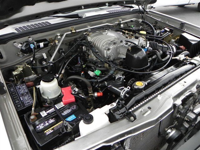

2. Get a good cool air system. I figure this will kick up the power a good bit and get me some much needed mpg back.

Here are some pictures of her:

Back in the 80's my dad wanted tubeless tires on his F250 (1967) and the only way to do it was to get 16.5 inch rims (stock was 16). He did that, speedo showed .8 miles for every mile driven and the speedo showed 45 when he was doing 60,, larger tires throw off the speedo and mileage, is that a possibility in this case?

that's something you'll have to compensate for when
figuring up your fuel mileage. If you google Tire size
calculator you should come across one on a miata forum.
I usually use this to figure out how much my speedo is
now off. Input the stock size and then input your size
and it'll give you the difference. Then when you fill up
take the mileage you just driven and times it by that,
add the product to the mileage and that's approx what you
just driven. I think you'll find you're getting better
than what you think.
I had a F250 at one point with 35" tires. Figuring up
just with what was shown on my trip meter i was only
getting around 14 mpg, but once compensated for the
slower speedometer because of the tires I was actually
getting closer to 18 mpg.
