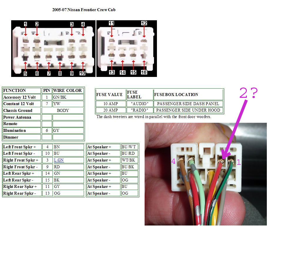

Could somebody tell me what the red wire (pin 2) goes to?

ok according to your diagram this is what the numbers do.
1 accsseory 12v +
2 illumination
3 right front speaker +
4 left front speaker +
5 not used (some have the chassis ground in them) -
6 dimmer
7 battery 12v +
8 power antenna +
9 right front speaker -
10 left front speaker -
11 right rear speaker +
12 remote amp turn on +
13 right rear speaker -
14 left rear speaker +
15 left rear speaker -
16 remote amp turn on -
This is the standard lay out for ALL nissan radio harnesses.
