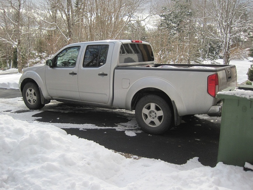

2006 4x4 SE 4.0, 73000 miles.  When I bought the truck 2 yrs ago I was getting 20mpg.  Afew months ago it started drifting down to 16.5 mpg.  Today, I got 50 miles out of 1/4 tank!!  went from approx 325 miles per tank to (now estimated) 200 miles per tank.  Truck starts and runs well, but does not seem to have quite the ooomph it did at first.  I change the oil regularly.  Tires are always up to max pressure.  Air filter is checked regularly and is clean (not a genuine Nissan oil impregnated one - sorry Frontierguy, you can jack me up for that).  The tailpipe is not sooty at all and the exhaust does not smell rich.  (maybe the cats are working overtime?)  anyway, the only code the IPDM has thrown in 2 years was for a faulty/leaky fuel vapour purge valve.  I cleaned the unit and the code was reset. No codes since.  I also cleaned off the MAF (or AMM?) with the proper cleaning spray and no change.....is it possible I have a faulty O2 sensor(s) pre cat that is not throwing a code?  Any other possibilities?
