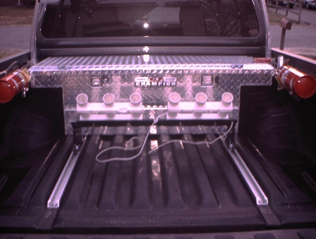

Delta now makes their Champion series for short bed mid-size trucks like the Frontier. Made like a crossover box, but the extensions at top of box fit over wheel wells. Sits on bottom of bed. Have mine attached to Utilitrac with 3/8 elevator bolts and wing nuts on inside. Loosen wing nuts and slide whole box out if need to.
