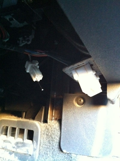

After scouring the interwebs I was unable to find a true do it yourself method for resetting the tire pressure sensors in my Frontier that didn't require special tools. Managed to figure it out so thought I should share. I've done it twice now (switching summers / winters) on my '06 Frontier, can't confirm it works on other models, but would think that it should work on 05+ Frontiers and Xterra's at the very least.
1. Set your tire pressures to the following:
Front Left - 36 psi Front Right - 33 psi Rear Right - 30 psi Rear Left - 27 psi
2. Turn the Ignition to "ON" but don't start the engine (key on, engine off). 3. Ground the TPMS plug 5 or 6 times, about once per second seems to work. This is a small white plug under the dash by the drivers right foot, right with the ODBII plug. You can get a special tool to ground this out, or use a wire, paperclip, needle, etc pushed into the plug (Don't use something too big) and touch it to the metal bracket that's conveniently right there (See pictures below). The tire pressure light on the dash should start flashing slowly and will continue to do so. 4. Start your vehicle and go for a drive, apparently you have to drive over 15 km/h, and it seems to take 10 minutes or so. Then the tire pressure light goes out for a bit, and comes back on (because you have a tire down at 27 psi). 5. Fill your tires back up to recommended pressure, and the light will go out. 6. Live happily ever after.
Location of the plug you need (with a needle stuck in it):
Grounding the TPMS reset plug:
Hope this helps some people out.

I can confirm the above procedure works on '07 Frontiers as well. Reset my tpms light last night and everything worked fine. Had a very cold night a couple of nights ago and it tripped a low voltage code in the morning that made my TPMS light blink. Local tire store could read that sensors were working correctly later in the day but could not reset the system - recommended I take it to the deal for reset. Used this procedure instead and saved me a trip and some money.
One important item is that the tire pressures used for relearn/reset need to be set fairly accurately. The first time I tried, they were not and the relearn/reset failed. You will know because the drive time for reset increases to 15-30 minutes until the system times out. At this point you will hear a long audible beep from the dash and the TPMS light will stay on solid. This is the main difference from a positive reset (in positive reset, the light goes out with no audible sound, stays out a bit and then comes back on due to low pressure in RR tire). It will remain on solid until the system is reset or you start the relearn/reset mode again. If this happens, just make sure you have a good gage, reset your tire pressures, and follow the procedures above again and it should reset.
I used slightly different pressures based on a different post that also worked:
RF to 34psi, LF to 31psi, LR to 28 psi and RR to 26psi
Thanks Kornhole!

treid it about 4 times with no success..put a new aftermarket tpms on it..the tire store said the guage was reading all 4 tires..the light went out for about 2 hours then went on again and tried to reset it 4 times with this method . after it resets the light stay on solid ..

I haven't tried this with aftermarket TPMS, so perhaps that's the reason. I've got two different sets of stock ones, and haven't had an issue.
Are you filling the tires back up to the appropriate pressure after resetting them? Once they are set up, you have one tire with low pressure, so by default the light will come on until that tire is topped back up.
