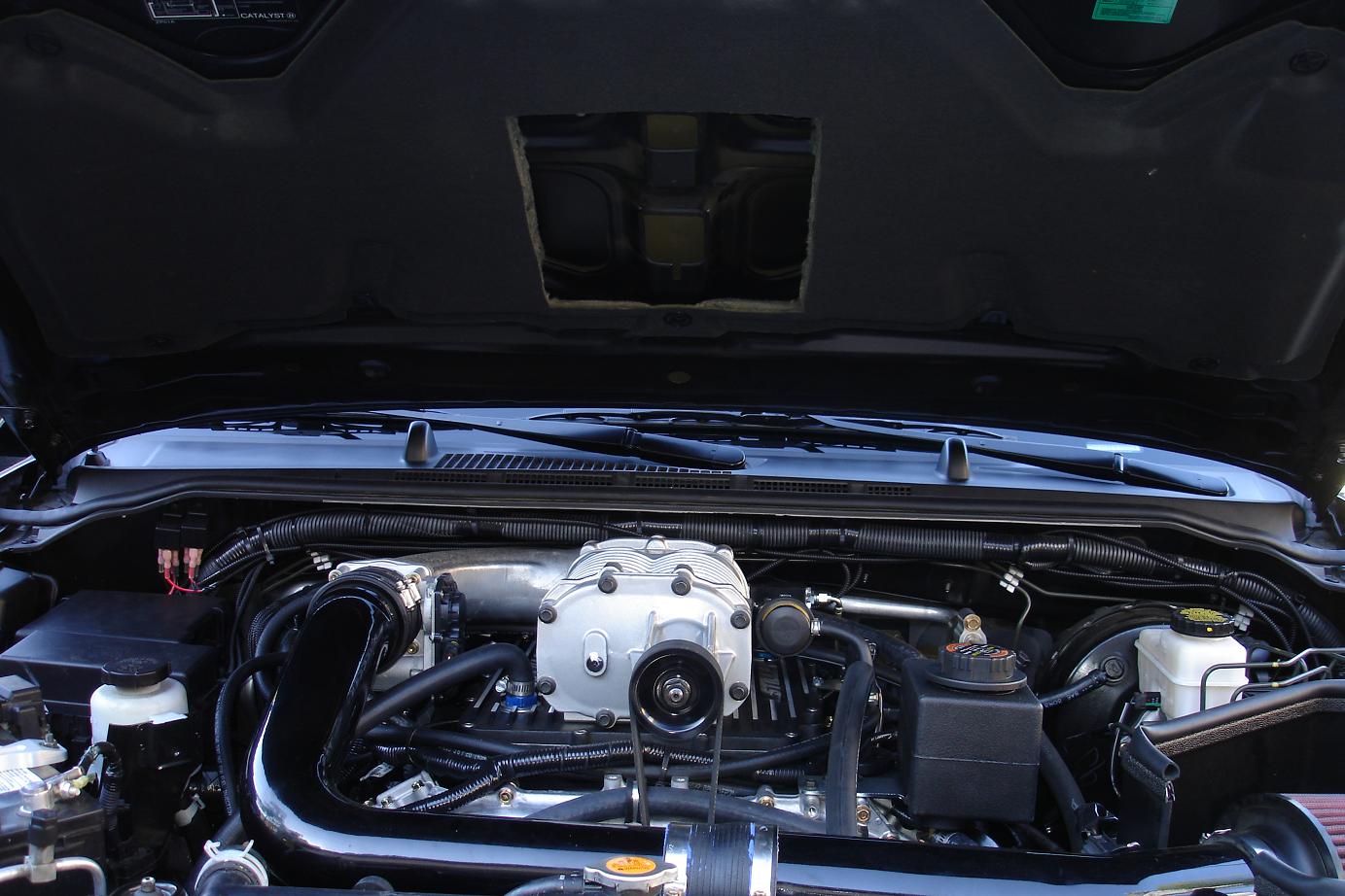

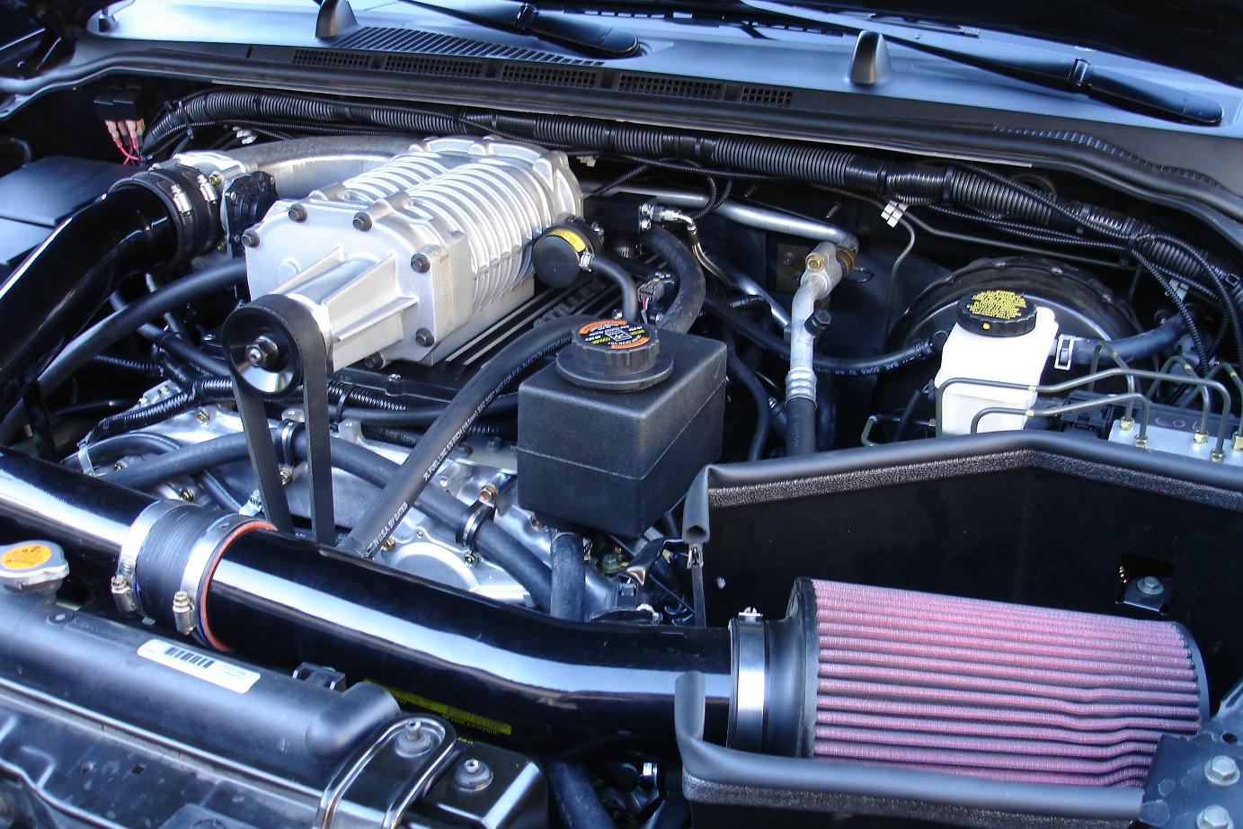

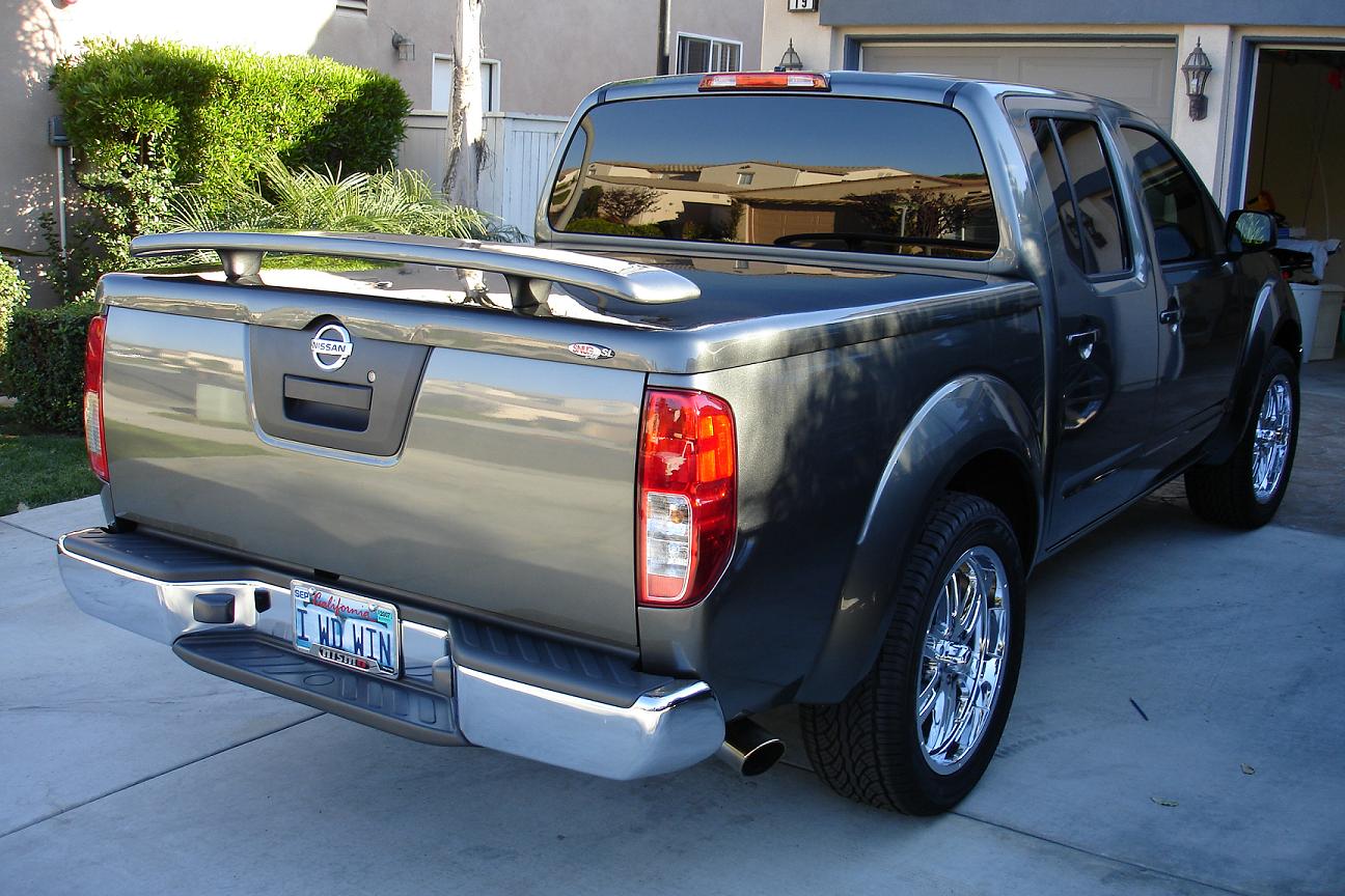

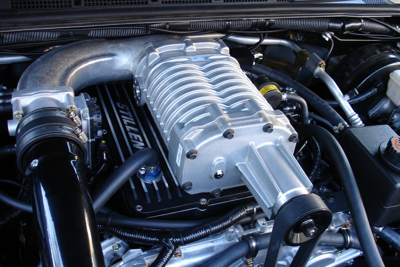

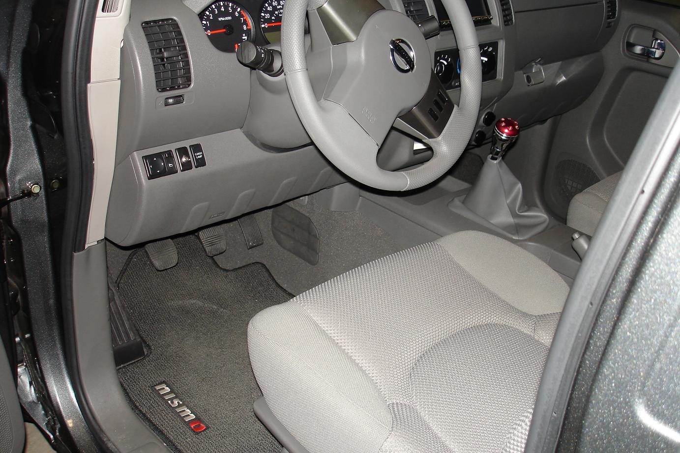

I just got the truck back yesterday from Stillen. They did a baseline dyno and an after install dyno. The baseline dyno was NOT a stock dyno. The Fronty had NISMO cold air, NISMO "R" headers, Banks exhaust and aftermarket wheels. The after install Dyno had the supercharger, headers and exhaust. Also, the Dyno measures RWHP, not flywheel which is what the manufacturers typically rate the vehicles. the baseline Dyno was 256 RWHP and 270 ft Torque. The after install Dyno was 339 RWHP and 315 ft Torque. with the tranny and wheels, I am losing about 25% from the flywheel. So to compare Manufacturer HP ratings, I went from about 260 HP to about 451 HP. This truck is pretty awesome with the 6 speed manual. I am attaching pics with this post.
